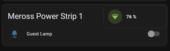

I use card_mod to use custom css to compress elements together as well as custom:stack-in-card to merge elements together.
Is there a way to globally change the theme to remove the new outline as it’s now quite prominent on my dashboards?
e.g.
Hello :slightly_smiling_face:
There is an open PR for stack-in-card to fix this : Home Assistant 2022.11 compatibility by ov1d1u · Pull Request #47 · custom-cards/stack-in-card · GitHub
I’d like to remove it globally as it affected the look on all cards, not just ones where I use stack-in
e.g. this is only using css to move the socket WiFi signal strength up into the entity card
card_mod:
  style: |
    ha-card {
      box-shadow: none;
      background: rgba(0,0,0,0);
      margin: -130px 0px 0px 300px;

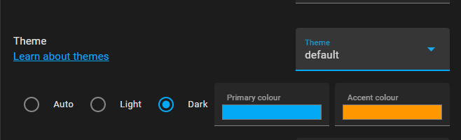

Ok - so I tried this and now all my themes are black. I have no light/dark capability now. Where has it written its changes so I can undo them. Setting a new theme is NOT overwriting the black background any more.
There’s an option when setting the theme to force light or dark.
Also 2 other places to check.
In your profile, select the theme for your user:
You may have to edit the raw YAML in case it’s hard coded in there instead.
