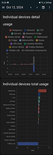

I have a Zigbee smart plug named Teddys Lab that I am now using to monitor my mushroom dryer. However, I used it a year ago to measure a heating element, and now, after reconnecting it and renaming it, it starts with a value of -9 kWh.
I’ve checked in Developer ToolsStatistics, but I don’t see any option to delete the history or reset the readings. The ramp button let’s me see “outliers” but they are a) numerous, b) fairly small (<0.3kwh) and c) can’t be deleted, only “adjusted” (with unclear effects). Manually click through hundreds of these “outlier” entries can not be the intended path.
