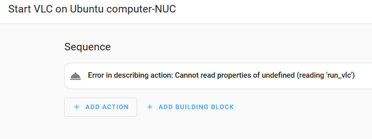

I have a shell command in configuration.yaml:
#shell_command:
run_vlc: 'ssh user@ubuntu_pc "bash /path/to/runvlc.sh &"'
(The Bash script on the ubuntu computer runs VLC Media Player).
But, I can’t figure out how to run the shell_command from a script. The shell_command is not an action but service: has been depreciated.
Ideas would be appreciated.

4
Thanks for the tip- I hadn’t thought of that. (I’ve only done one shell command a long time ago).
You would think so, but it is not an action, so it doesn’t drop-down in actions:
When I go into the script UI, the manually entered script in scripts.yaml shows an error.

7
they don’t create entities but they do show up as actions.
here are some of mine:
and they also show up in the action page of the dev tools:
it’s likely there is an issue with the shell command configuration that is preventing it from being created.

8
Thanks for the help. I don’t know what I did but the shell command is in Actions now.
