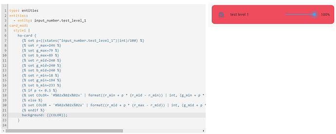

Cannot say anything about the template itself & mushrooms - but with a standard Entities card + card-mod it gives some color.
My input_number ranges [0,100], minimal color “#31c1e8” (0%), maximum “#f34d5b” (100%).
No idea why you are having different values; probably we are using input_numbers with diff. ranges.
code
type: entities
  - entity: input_number.test_level_1
card_mod:
  style: |
    ha-card {
      {% set p=((states("input_number.test_level_1")|int)/100) %}
      {% set r_max=246 %}
      {% set g_max=79 %}
      {% set b_max=89 %}
      {% set r_mid=240 %}
      {% set g_mid=240 %}
      {% set b_mid=240 %}
      {% set r_min=18 %}
      {% set g_min=194 %}
      {% set b_min=233 %}
      {% if p <= 0.5 %}
      {% set COLOR= '#%02x%02x%02x' | format((r_min + p * (r_mid - r_min)) | int, (g_min + p * (g_mid - g_min)) | int , (b_min + p * (b_mid - b_min)) | int) %}
      {% else %}
      {% set COLOR = '#%02x%02x%02x' | format((r_mid + p * (r_max - r_mid)) | int, (g_mid + p * (g_max - g_mid)) | int , (b_mid + p * (b_max - b_mid)) | int) %}
      background: {{COLOR}};
