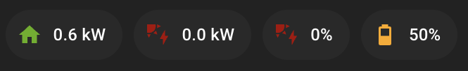

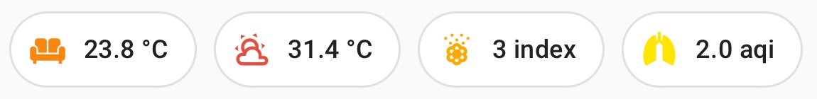

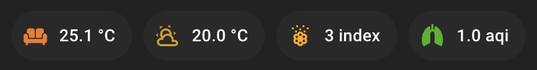

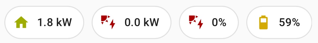

Dynamic badge label (text) colours
I originally wanted to create temperature badges that apply colour according to the temperature value, so I’ve created something that can be applied to essentially any continuous numeric sensor value.
Before the 2024.8 badges redesign, I opted for colouring the state, but I’ve now switched to colouring the icons instead. This is a personal preference: It just looks better to me. You can have either or both. The code for setting the state (text) colour is included below.
With a light theme:
With a dark theme:
The code uses a combination of card-mod and mod_card (which is part of card_mod):
