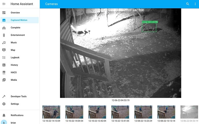

I use zoneminder, running on another machine, with zmeventnotification, an AI capability to do object detection. ZMeventntofication is used to identify cars, people and some animals. When any of these are detected I use an add-on associated with zmeventnotification to FTP the pictures to HA, making objects tagged pictures available in HA. This uses the HA FTP add-on receive the pictures. Both ZM and HA access the video streams, so I can pull up a live feed in either system. I also use aqara motion and contact sensors with HA’s alarm panel to provide security system functionality in HA. When motion or contact sensors detect an alarm event I grab snapshots with the camera’s on HA and email a picture to whoever is monitoring the house via an automation. I also use twilio to send send an SMS to whoever is watching the place. For each camera I can also pull up the last 15 tagged ZM photos in HA. I use the HACS gallery card to present the ZM tagged photo’s. Here’s a shot of the gallery card for one camera:
This shows accessing one of the camera’s using HA:
Here’s a shot from ZM showing the event interface to look at all detected activity:
An example of my automation and associated scripts called when alarm system is activated and motion is detected
