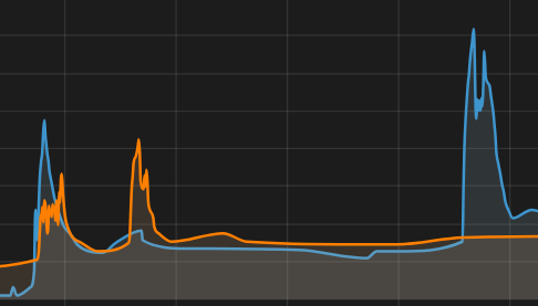

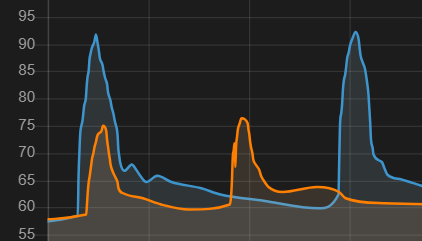

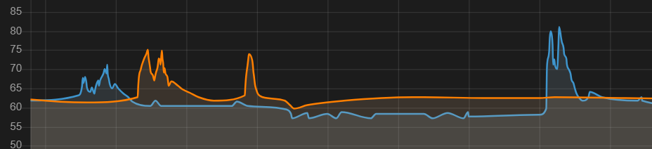

I have 2 humidity sensors in my 2 bathrooms, and looking at the graph, figured everyone probably could tell that I have 4 people taking showers each day.
