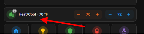

Simply put, I’m trying to add the humidity from the same device (thermostat) to the secondary information section of this mushroom climate card:
From the UI editor I only have a few options to choose from: Default, Name, State, Last Changed, Last Updated and None

It’s from the Honeywell T6 device for sure. I’m just not sure how to make the code work to have it display as the secondary info text on that card.
I don’t think you can. Those are two separate entities - climate and sensor.
The card will only allow a small subset of the climate entity properties as secondary info. It will not allow you to show the state of a different entity.
