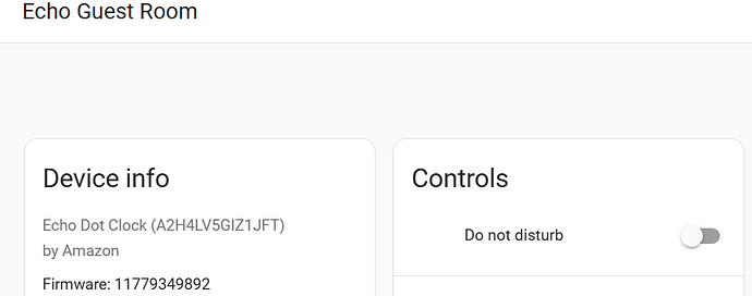

I just tried to swap one of my Alexa entities in an automation that sets the volume on that device. Unfortunately, the only option with the new Integration is to change status of Do Not Disturb. I’ll do some more research, but not sure that all options are available (yet).

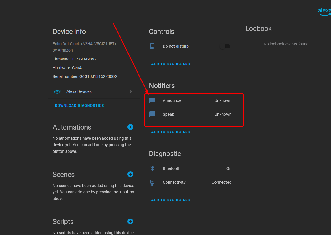

You aren’t looking at the correct entities…

that doesn’t seem like the right name, my everywhere is called notify.everwhere_anncounce or notify.everywhere_speak
