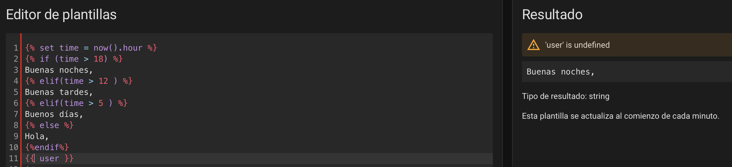

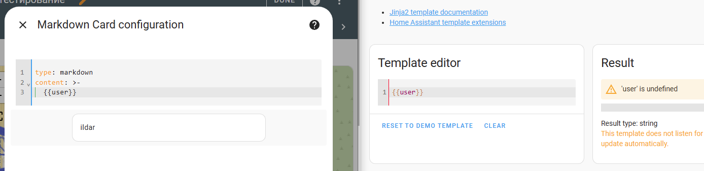

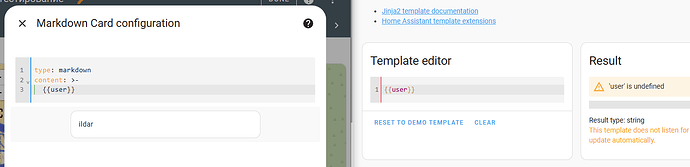

It outputs the name of the person currently logged in to the device you are currently using.
So basically you can use {{ user }} in place of a name like John or Elizabeth… whoever comes through the door and triggers an automation using a name it’ll replace it with whoever the person is?
Not exactly. It’s more something you would use as a greeting on a dashboard. It displays who is logged in on that particular device. So it could be used in a template card as a greeting on your dashboard.
