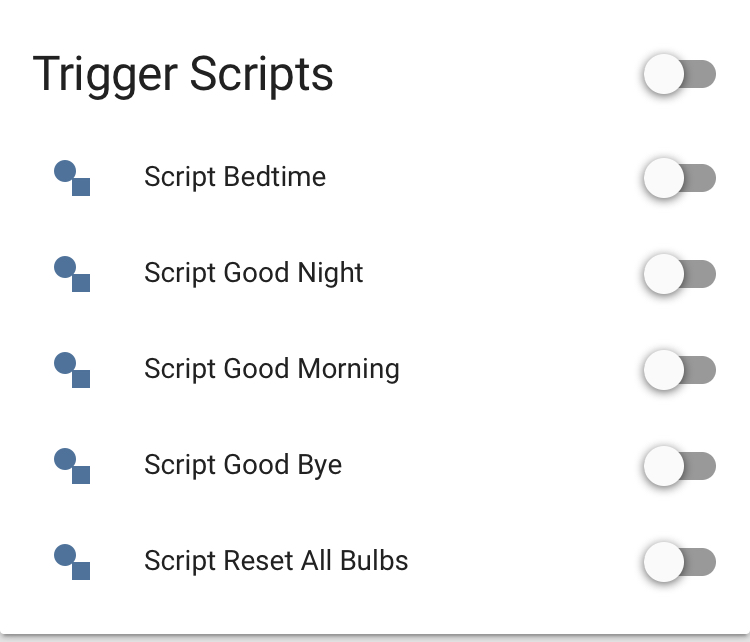

This is how I did it.
I created a few input booleans to run my scripts.
I placed them in a single group so I can easily reset all of them to off after that any of them has been executed.
In node red I look for changes of the booleans to trigger my node red scripts.
I also turn off the group after my commands are done.
I then expose my booleans to my google assistant.
Then I created routines in the google assistant app to allow me to say “okay google, bedtime” instead of “okay google, turn on bedtime”. And the same goes for “good bye”, “good night” etc…
