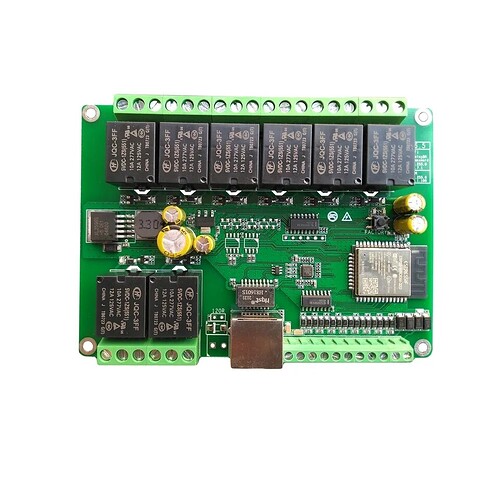

But when Esphome evolved and also included support for BLE temperature sensors I have switched to ESPhome thermostat using BLE temp sensors directly connected to the esp32 relay board in case that homeassistant goes offline I still have heating.
Have added a BLE temp sensors in each room and using the average temp for that zone to call for heat.
So far my gas bills are very low in winter time comparing to other households around me and I have set the temp to 22 degrees at all times.
Used below relay board with ethernet to free up ESP32 WiFi for BLE scans of the temp sensors.

For hardware depends what you are looking for, in terms of zones.
I have 3 heating and one hot water zones, in total I needed 4 relays.
The Esphome thermostat is a set and forget, no need for a fancy screen on the hardware itself.
The board I got is coming with a din rail box and can be installed inside a plastic project box.

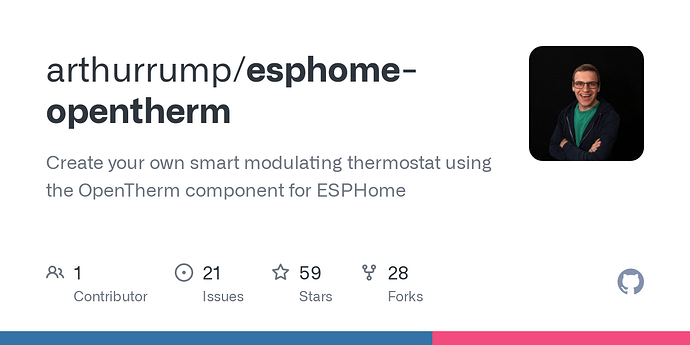

I’ve had this in use now for over three months and I must say, the idea of using a PID based thermostat is gone. What I want to try now is using one that controls the flow temperature of my boiler, adjusting that to maintain a setpoint in my house.
Does anyone know of an integration that will work like that?
Below may work for you if your boiler supports Opentherm
