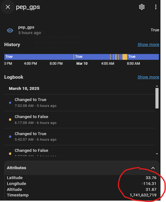

This is my recent history for sensor.pep_gps, e.g.:
Finally, the automation that updates my home location based on the sensor.pep_gps attributes that are updated above:
