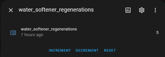

The difference is what I have implemented from what was discussed is that an automation watches for the water softener power consumption and increments a counter. This is because the softener valve rotates a few times and spikes power > 4 each time it does so. Clearly from my perspective these additional spikes all constitute one regeneration. So it is easer to have an automation trigger on the first spike and then delay for an hour to effectively ignore the additional spikes of valve rotation.
With this implementation I can manually increase the counter via the helpers interface which I have done “two times in short succession” to test the code out. Once the first “real regeneration” happens, this won’t be an option as it will mess with the data.

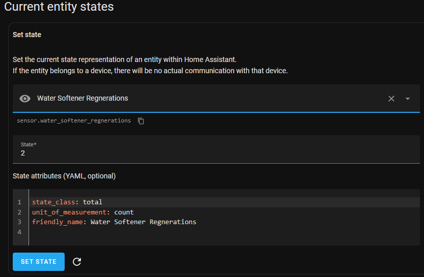

I am not clear whether what I am seeing in the state under dev tools states is truthfully what is expected.
I was expecting to see some timestamps and a history attribute in there as well. Or does that not appear in this case do we know? Or have I totally goofed on how this works?

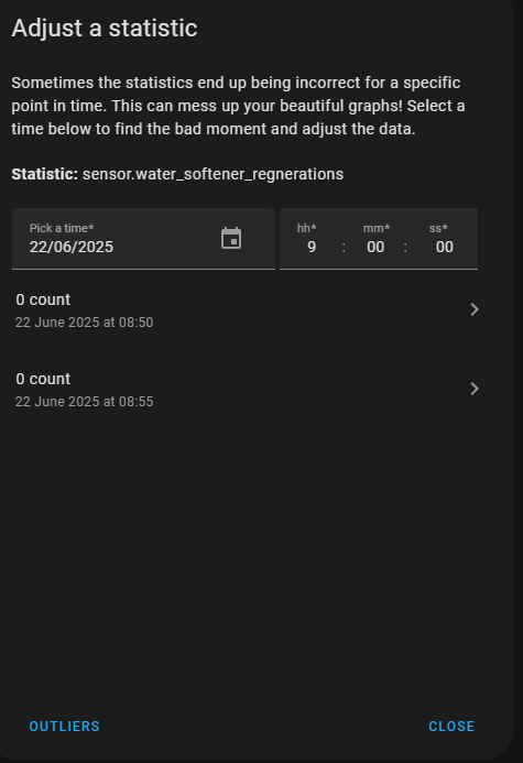

In the sprit of clarity here is an image of the statistics for the sensor entity.
Also a screen grab of the counter entity. It already existed and had a state of 3 before this modification which is the reason why the state is = 5.
I am wondering if what I have done wrong is obvious at all? Or whether I just have missunderstood perhaps?
Sorry, when renaming some of the variables I forgot to change one. A tip for next time: make sure to go to your logs and see if there are issues whenever something isn’t working as expected. In this case, the log error should state
Error rendering attributes.history template for sensor.water_softener_last_regen: UndefinedError: 'history' is undefined
Seeing that error is how I realized what mistake I made.
"days_since_previous": ((now().timestamp() - (prev_history[0] | default({"datetime": now()}, true)).datetime | as_timestamp ) / 60/60/24) | round(0) }] %}
                     I forgot to rename "history" to "prev_history"
Once you change that line it should work as expected.

friendly_name: Water Softener Regnerations
I would suggest you paste the template from the conditions into developer tools → templates and that will show you whether it evaluates to false or true. You can then dig into it further, for example remove the < now() from the template to see what the datetime is that is being calculated. Or just enter {{ state_attr('sensor.water_softener_regenerations', 'history') }} to see if it outputs what you expect.
I say all this already knowing that the problem is probably that you have the incorrect entity_id specified, and that last line will probably return null. Take note of what your entity id is. I see in an earlier post your code showed:
And that will get slugified as the entity id. Note the misspelling of “Regnerations”. Therefore I suspect your entity_id is sensor.water_softener_regnerations which is one letter different from what I had in my code.
I spent a good amount of time reading the documentation (HA docs and jinja docs) and these forums, and trying various things out in my own HA installation to see how it works. I now spend a decent amount of time helping others because I always learn something in the process, and I enjoy learning about this.
It basically needs time which would prevent those foolish character entry errors, which your calmer clearer head has spotted. Thank you once more.
I just wanted to feedback that the salt distance sensor and the Softener Regenerations template are both working perfectly. The machine regenerated last night and co-incidentally I added salt yesterday evening. So I was a bit surprised to see the distance had changed in the morning. Then I saw the state of the template had incremented and the history and day calculation all had worked as expected. Now I can custom-buttoncard that into the dashboard. The board for the tank level sensor “JSN SR04T” should come today enabling that project to complete as well.
Many thanks once more one and all.
