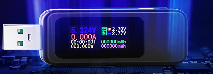

Just for fun, because I do not understand this really well, I did some readings using a board like this:
This is the Chromecast 850mA:
This is the Samsung Charger
And this connected to my laptop:
Of course those are just snapshots but at least on the Samsung one I see that it can go up until 0.134A
