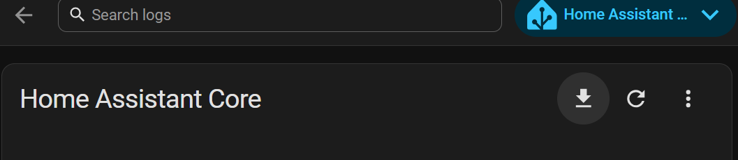

If you have access to the UI you can download the logs from Settings > System > Logs. There’s a download icon at the top right:
