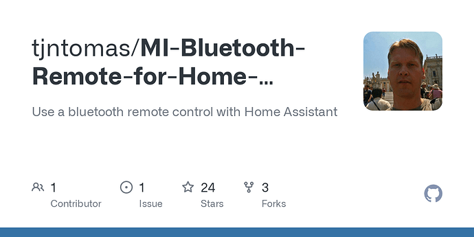

I think HA only natively supports Bluetooth Low Energy (BLE) devices. Many of those remote controls aren’t BLE devices, so they won’t show up in HA. You might look at this:
It looks like it might help you pair a regular Bluetooth remote so you can use it to trigger events.
