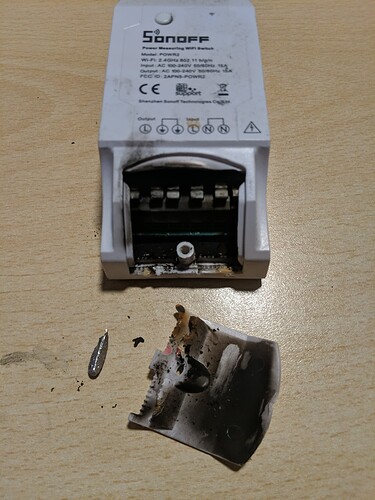

My boiler (220V 3000W) was plugged on a PowR2 without problem since 2 years, but our today morning experience shows it was a really really really bad idea!!! We were really lucky, the fire shut down itself. Phew!!

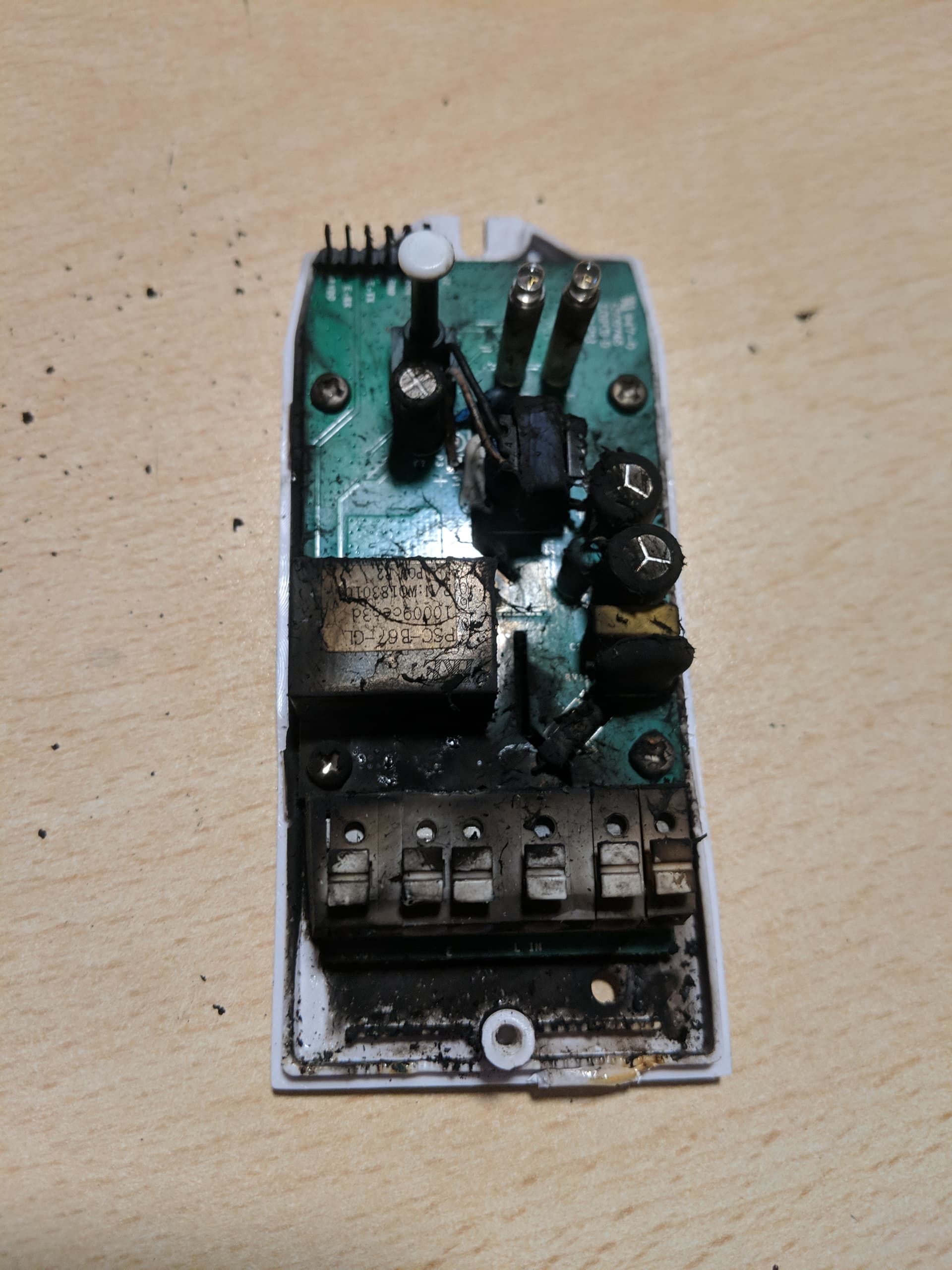

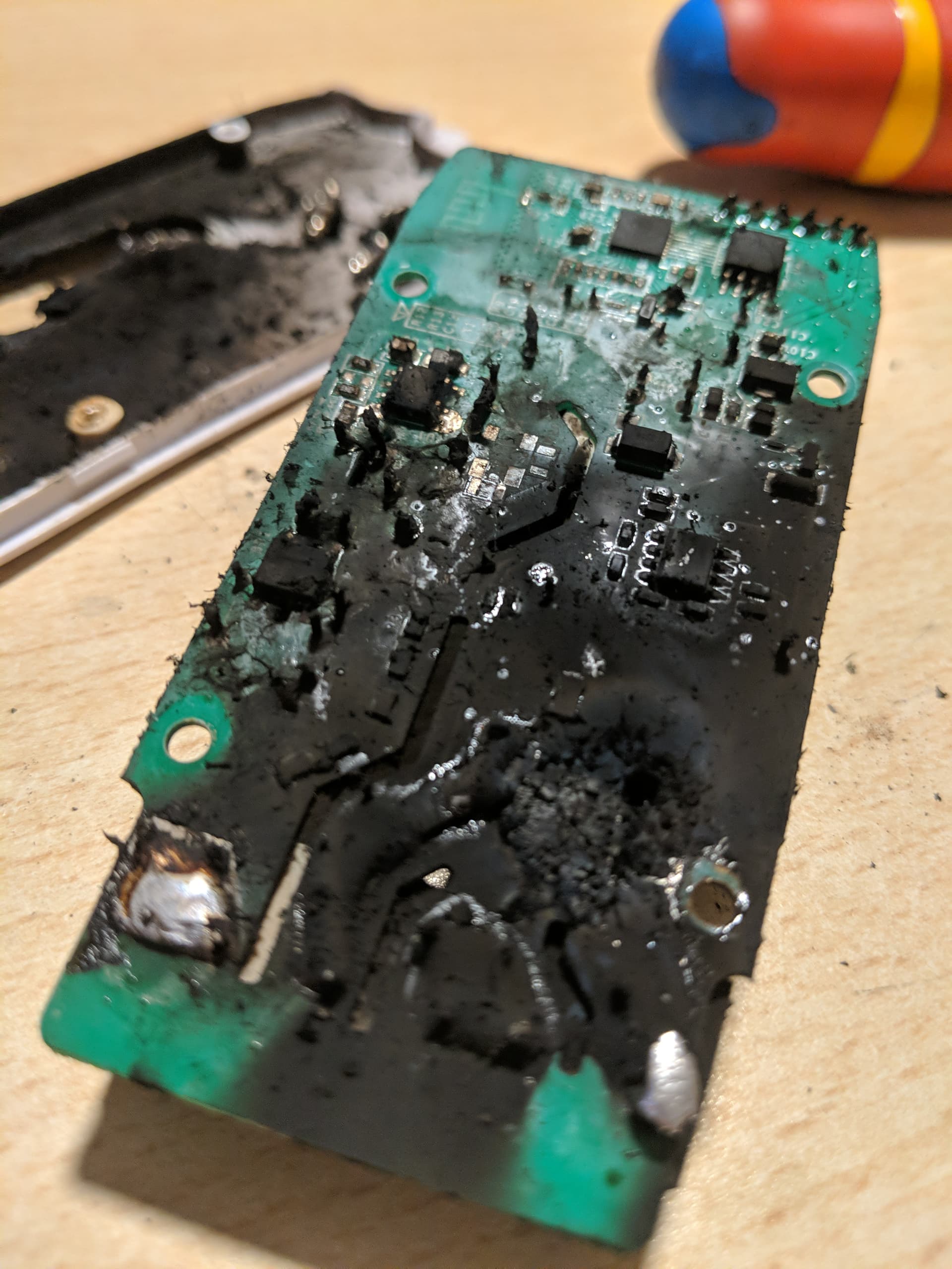

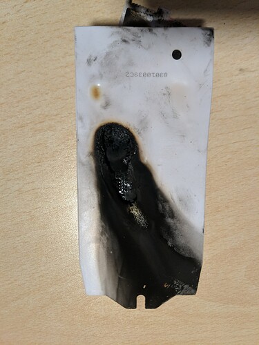

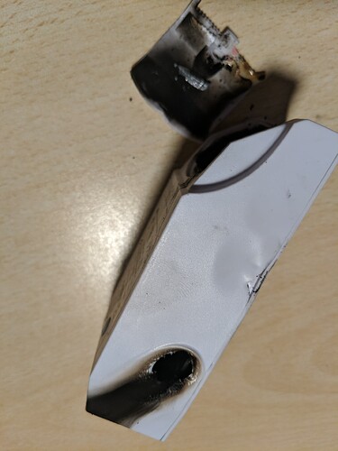

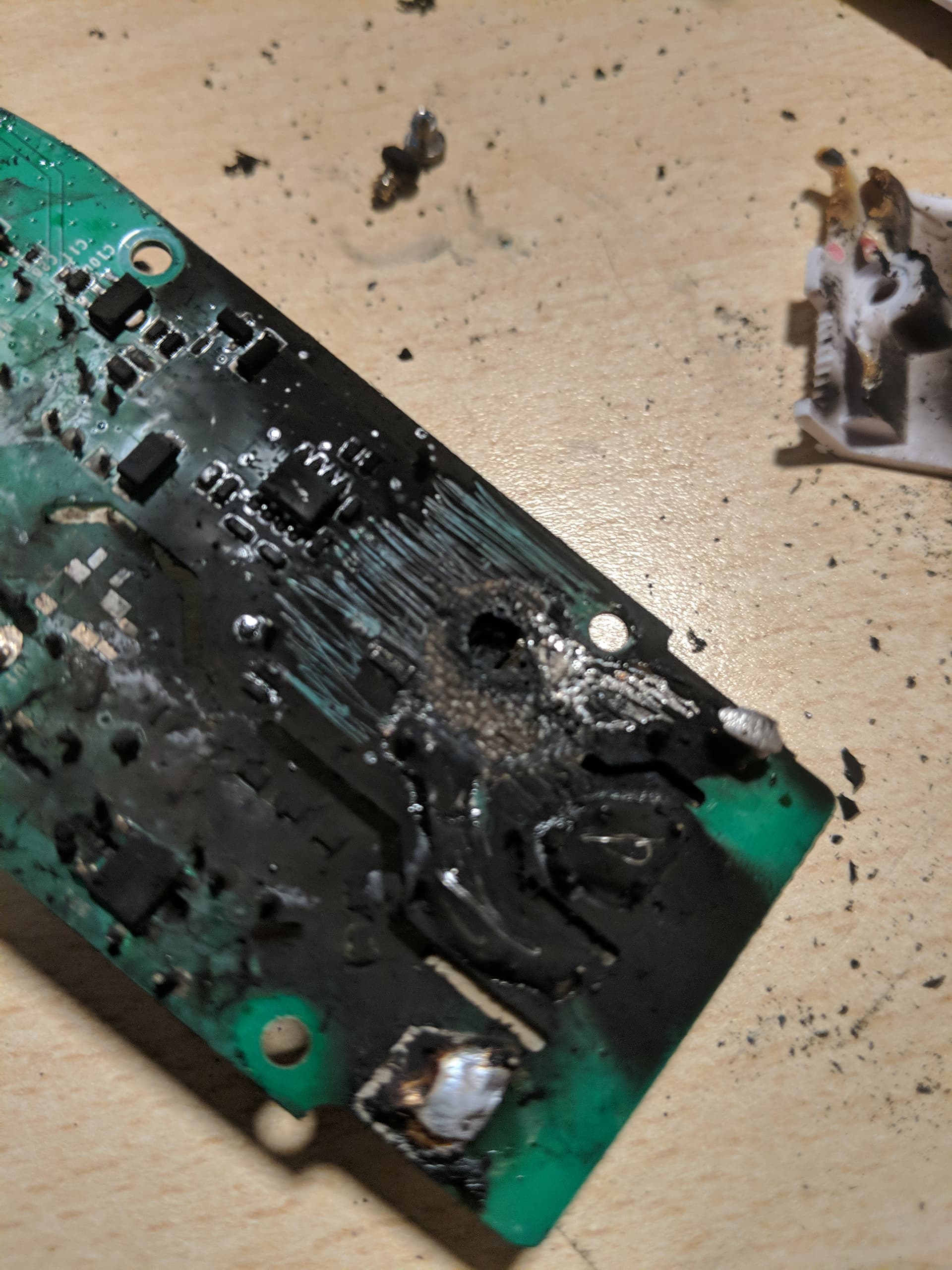

My sonoff pow v1 actually did not burned down, it just melted, luckily. I had it on my baking and microwave oven (two high load devices) in the kitchen and its been working for, i don’t know, 4 years maybe. Since recently i started to hear that relay click-clack sound. I have disconnected it and saw a melted plastic.
When i opened the sonoff, there were black burning marks from the fuse. The fuse F15 is still going, it just melted everything around itself, mainly the thin PCB where it was soldered. The thin copper PCB layer could not dissipate that heat coming from the metal ends of the fuse, therefor the tin went fluid. Luckily it did not short other connections down its way.
Oven draws approx 2000W and microwave another 1400W. Voltage on my network is usually about 240V. So about 14 Amps for the fuse inside sonoff. I can imagine it went that way only for 2 minutes on a a rare occasion, but it was enough to cause fire hazard. The worst part of it: it was still within the manufacturers specifications!
