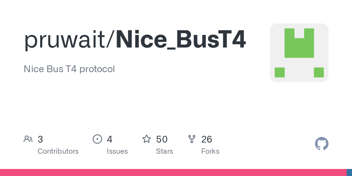

The only thread I was ever able to find was this one
And GitHub
Since I was in the same boat I was trying to find a way to use the bidiwifi but the link to the fork and bin file for the esp32 didn’t work
