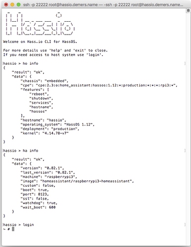

Once i SSHed onto the rpi3+ (no matter how i did it) i always ended up in the hassio restricted shell where very few commands are available. Never noticed the banner saying we could type login and access the base system. I reread dozens of times the -help of the hassio command and it never states that we can just type login to access the remainder of the commands.
Once i typed login, for my particular problem, i could just type
docker exec -it 21332546_influxdb influx -username XXX -password XXX
and i was in, ready to do my deeds !

nothing, i type for my computer
ssh -p 22222 [email protected]
which logs me in the hassio restricted shell and then type
login
I’m not asked for a user name or password (i guess because i’m logged in as root)

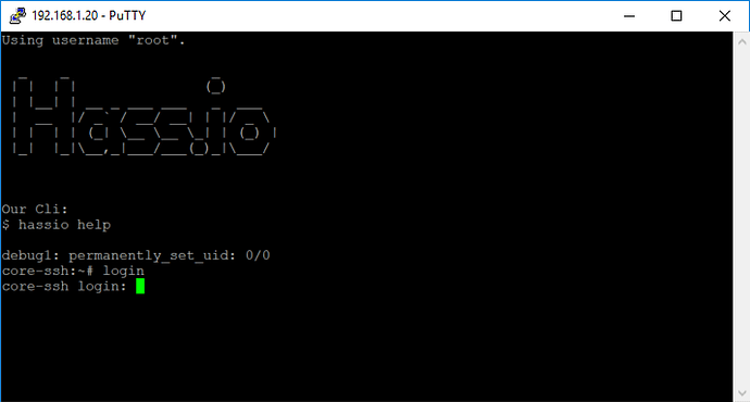

what version do you have?
here is a snapshot of putty where you can see that the login command prompts me for a user.
ok worked for me too, but i have to work on the rpi and not connect to it using putty
