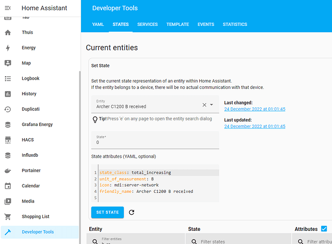

ok, but how to access the timestamp visible in post 1? It sits behind an @ and any state selector fails.
That is not behind a @ sign, this is the value 'last updated
{{ states.sensor.archer_c1200_b_received.last_updated }}
of example:
