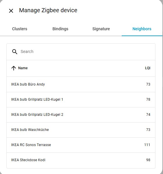

Running ZHA, how can I access the neigbour’s LQIs of a ZigBee device as they are shown in the “Manage ZigBee device” dialog of the ZHA integration?
At the end, I’d like to bring these values to a templated Sensor or use any other means to display these values somehow in a dashboard.

I already have enabled the LQI sensor of the device, but I want to access the LQI values of the device’s neigbours, as they are shown on “Manage ZigBee device” dialog of the ZHA integration.
So the result must be a list with 1-n members, not only the 1 value from the device’s LQI sensor.
