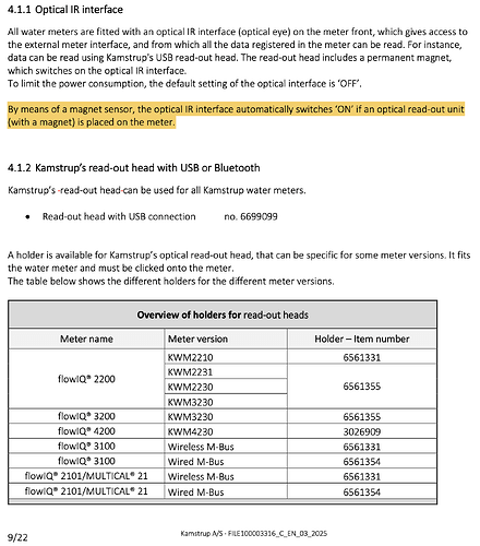

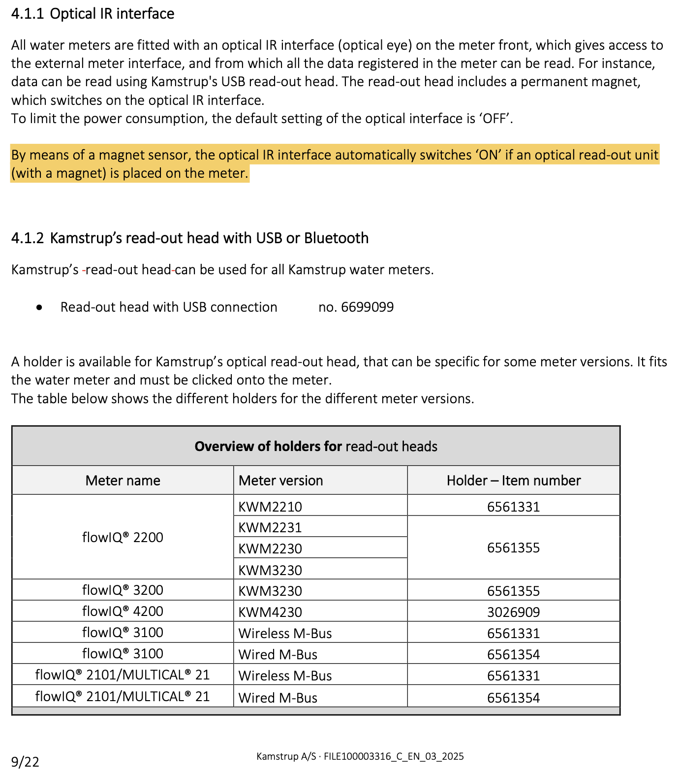

I received this document from the manufacturer today. It states that the IR interface is activated via a magnet.
That’s the magnet to activate the full read access. That doesn’t activate the continuous “one ir blink per 10l” mode
