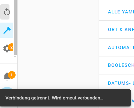

FIRST: THANKS A LOT !
for all those on HA OS this folder means
homeassistant/www/custom.js
First I had searched for the config folder which I could not find, but when I saw the www I remembered, that this is the local directory used for jpg and js and so on.
And then I remembered that “config” in this case means the homeassistant install directory like local/www adresses that directory.
Here is a screenshot of how that looks and feels.
ATTENTION: if you click that upper circle button (above the hammer icon) you will have no
further interaction and the restart will begin without further interaction, no way to stop it !
Once you have clicked on the RESTART ICON then the “tools” page will be opened while the system instantly starts to reboot or starts stopping all automations before RESTART begins.
Again: RESTARTS means restarting your home assistance instance and bot rebooting which takes a lot longer cause then the full OS will be rebooted too.
