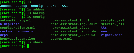

seems out of date since the mentioned path is: /usr/share/hassio/share
and on HAOS there is no hassio folder inside /usr/share/*
i can acces /share via SSH i can also open it via SCP in case there need to be a file transferred.
why would i need samba? and which container do you reference?

But I have a gut felling your actually SSH’ing into something else, maybe the main Docker image?
When using the Samba add-on it will go directly to the HAOS Docker container that has all the config files.
