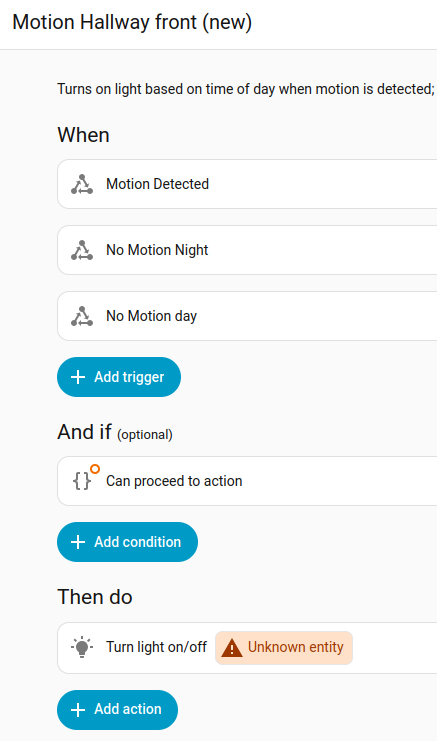

If you are interested, the following version takes advantage of Trigger Variables to move all of the control logic into each trigger (as opposed to employing a choose in actions). The result is just one action light.turn_on that sets the light to the brightness computed by the respective trigger's level variable (a value of 0 turns off the light).
In Visual Mode:
(I don't have your light entity on my system so that's why it indicates 'Unknown entity')
In YAMl mode
