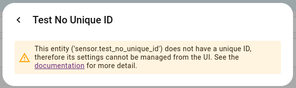

Are you certain it was defined using YAML and not via the UI?

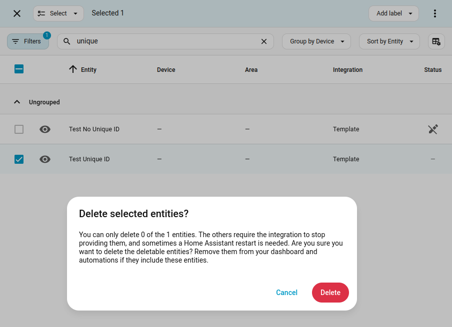

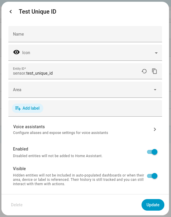

The reason why I ask is because the results of my tests show that YAML-based Template Sensors cannot be deleted via the UI.
I defined two Template Sensors in configuration.yaml, one with a unique_id value and the other without, and then tried to delete them via the Entities page. Home Assistant did not allow me to delete them.
For the sensor without a unique_id value it prevented me from changing any part of it via the UI.

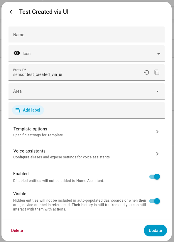

I then defined a third Template Sensor but this time using the UI and not via YAML. I was able to delete that one via the UI (delete button is enabled).
If you had deleted a Template Sensor that was created via the UI, there is no command to undo the deletion.
