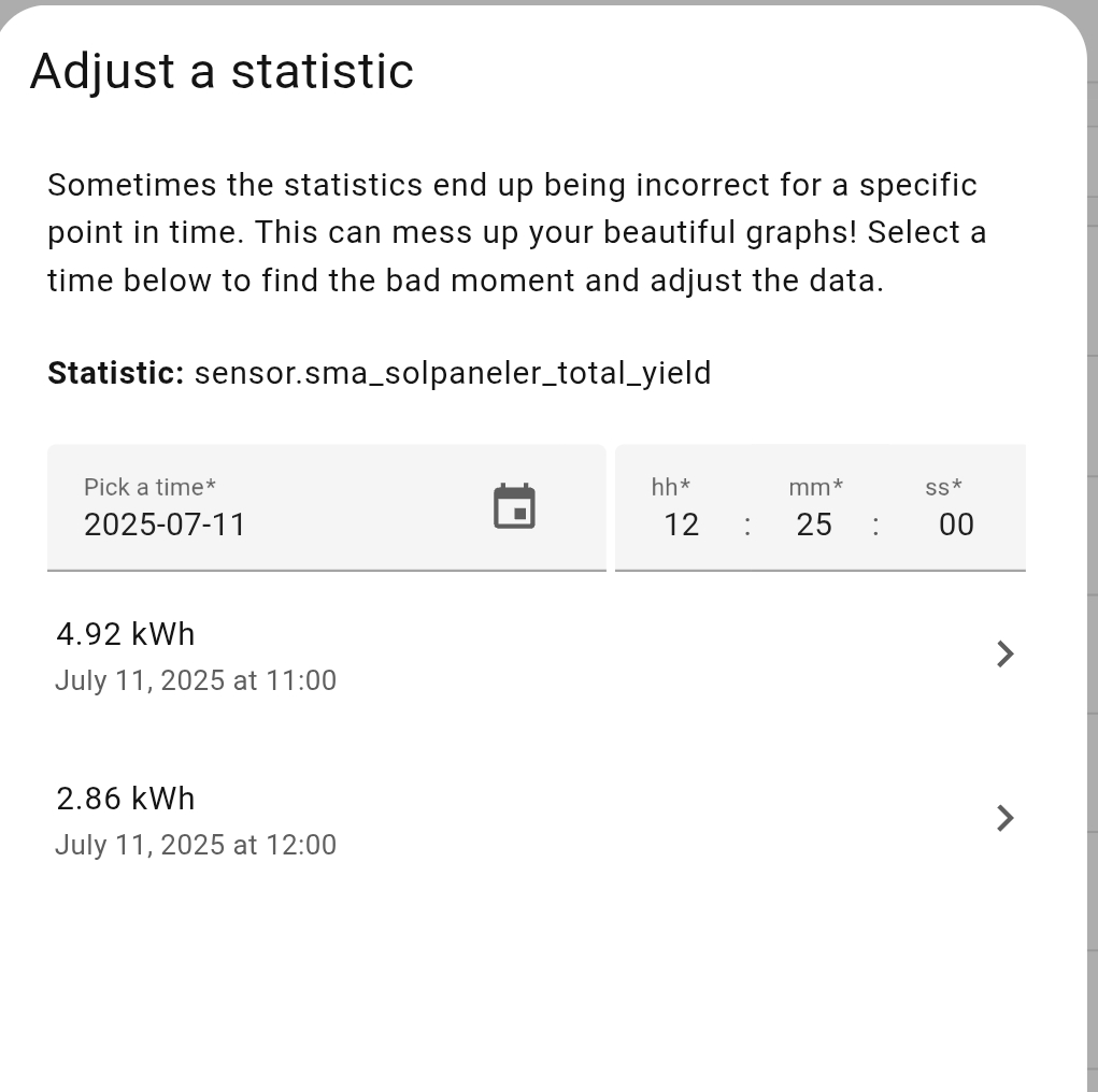

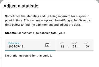

In Settings > Dev Tools > Statistics I can vorrectcrandom outliers, but how can I create missing data points?

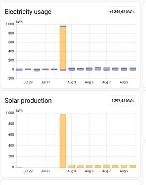

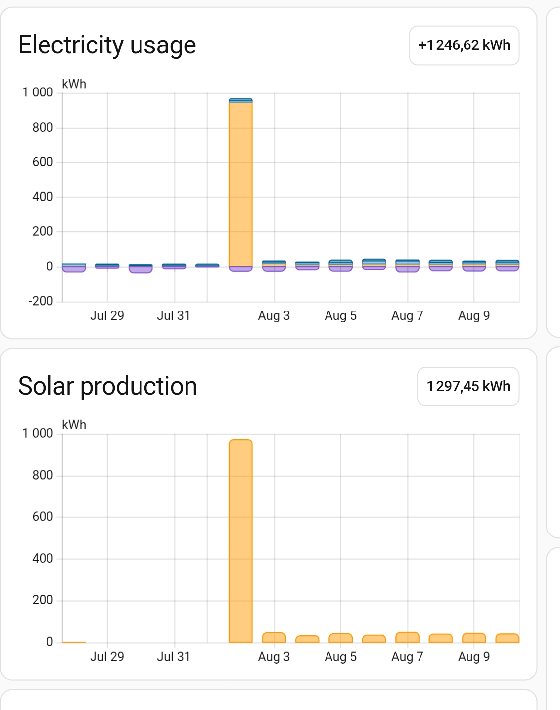

Here the inverter stopped transmission some time after noon
So, what I would like to do is to take the total, some 900+ kWh in the example above, and spead it out across the missing days. It will not be perfect on hour or day level, but very much better than now on week, month and year level.

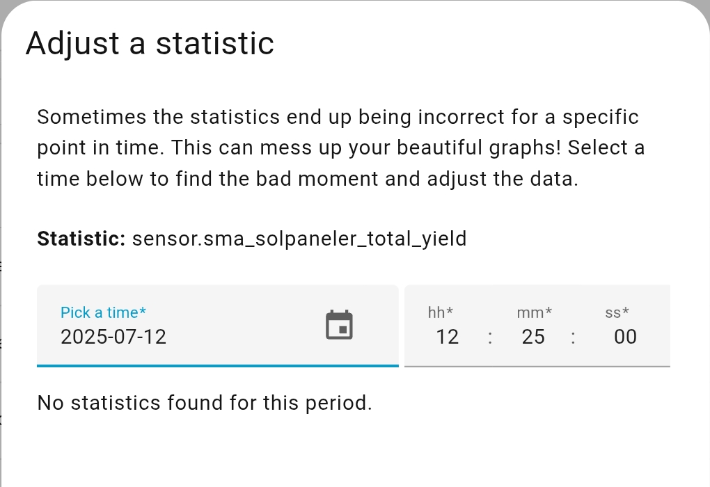

The only problem is that I have no refords to adjust for those missing days.
There’s no way to do it in the UI, it will take quite some ugly hacking in the database. Unless you are very skilled at SQL would recommend just leave it be.

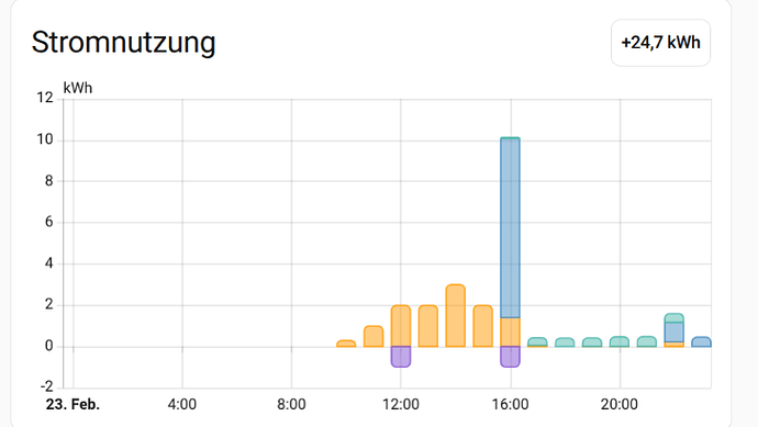

I have the same for the 23.2. and the jump was visible in the data.

I have checked it for my missing values, and in my case the 1h statistics are really missing for these hours. That would cause a more complicated repair (insert lines)
Ok, in principle that works but if it’s worth the risk destroying something has to be validated:
  • I could copy the last available data line to the day before
  • and by editing the sum value ths statistics shows now one additional entry
Yes that definitly works wwith this integration (already forgotten that it was on my plan):
