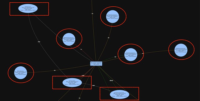

So as seen on the visualization page, the outlets do have a connection to each other and also to the SkyConnect. But how can i “force” the connection of an aqara over an Outlet/Router? Or is this done automatically in case the connection to the skyconnect is getting worse?
Im not sure if i can understand the diagram correctly:
Long line = poor connection, or high number = poor connection?
Red circle = Aqara
Red rectangle = Outlet / Nous

AFAIK you can’t do it for zigbee network (z-wave has such option). But in principle as long as you fully reset your sensor and removed it from your network it should find the nearest router. Did you confirm that it acts as a router? Not all powered devices do. I checked your diagram, and yes, you have routers there.

Could you explain how i can interpret the diagram? If the number on the line is high, does that mean the connection is good or bad? Also does the coloring of the lines have a meaning? Thanks!

I use zigbee2mqtt, so my map looks different. But some people are critical to the reliability of link quality values, because they are reported differently by different vendors.
