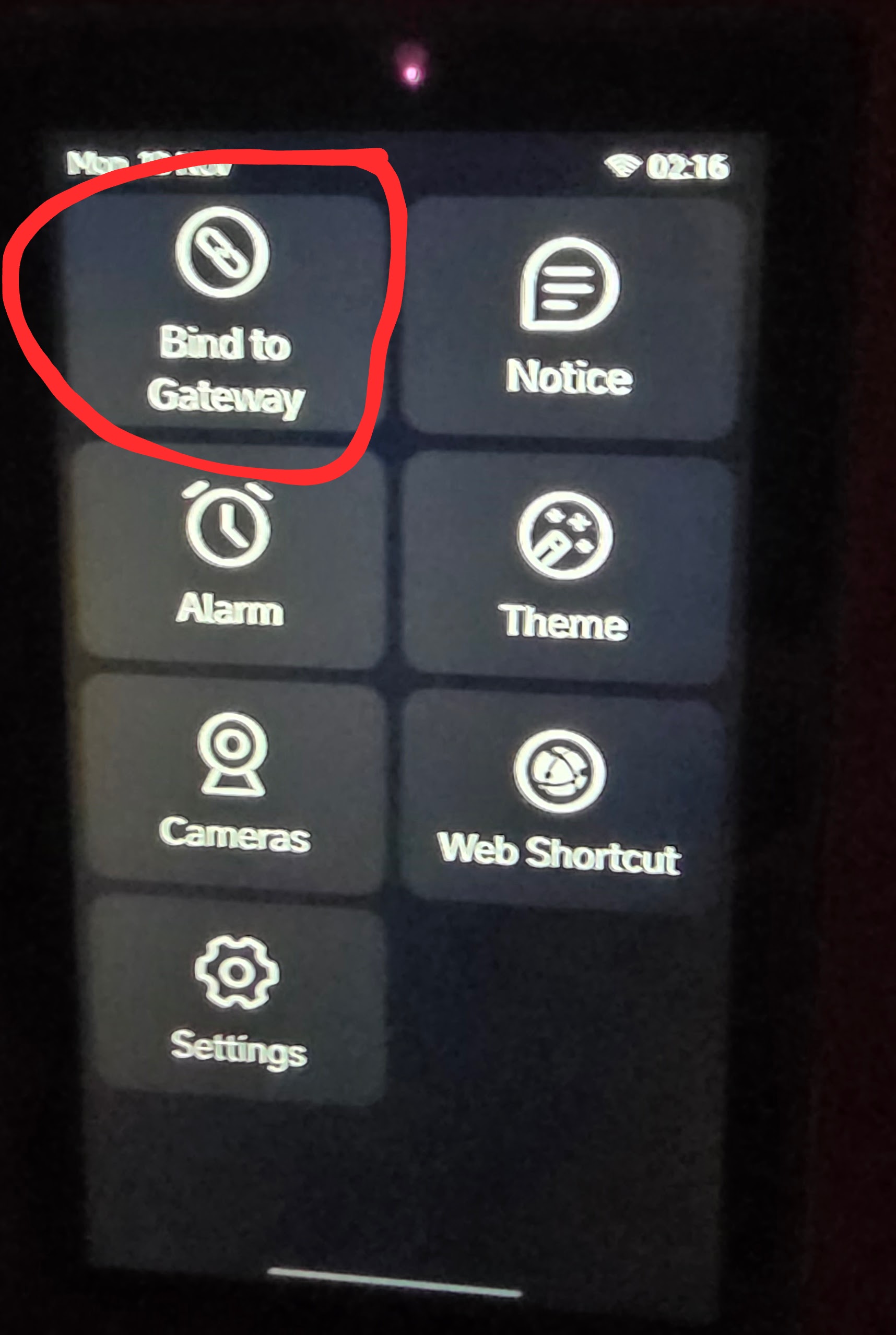

I have found the solution. After changing to router mode in the ewLink app, you need to delete the NSPanel and re-add it after rebooting.
After the NSPanel pro has been rebooted, a menu option is added that allows it to be paired to a gateway. Put it in pairing mode on the NSPanel pro, then Add Device from the ZHA UI and you’re good to go.

I cannot find this menu option once in router mode.
Could you please tell me where you find it ?

Swipe down from the top to show menu. Top left button should say “Bind to Gateway” Click that, then push the ‘Pair’ button in the middle of the screen. It will popup almost instantly when you click Add Device in ZHA settings.
