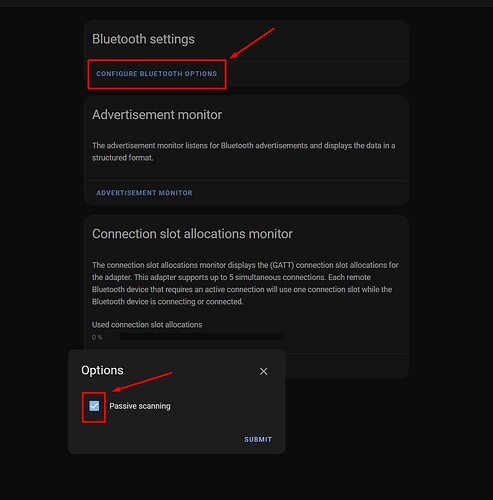

OK I got it to work, and I believe I know the issue.
  1. Go to: Devices & services → Bluetooth → CONFIGURE → CONFIGURE BLUETOOTH OPTIONS -
    Passive scanning (CLICK the box)
  2. Restart Home Assistant - Reboot system

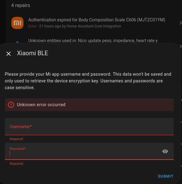

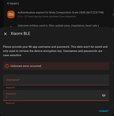

Sometimes after you step for 30 seconds, that is a trigger for the authentification.
I did that and it appear. The problem is that i just cant login to my account. I try everything and i dont know why it wont accept the password, using same email and password as the Xiaomi Home app
I try again today and now the error is
Unknown error ocurred

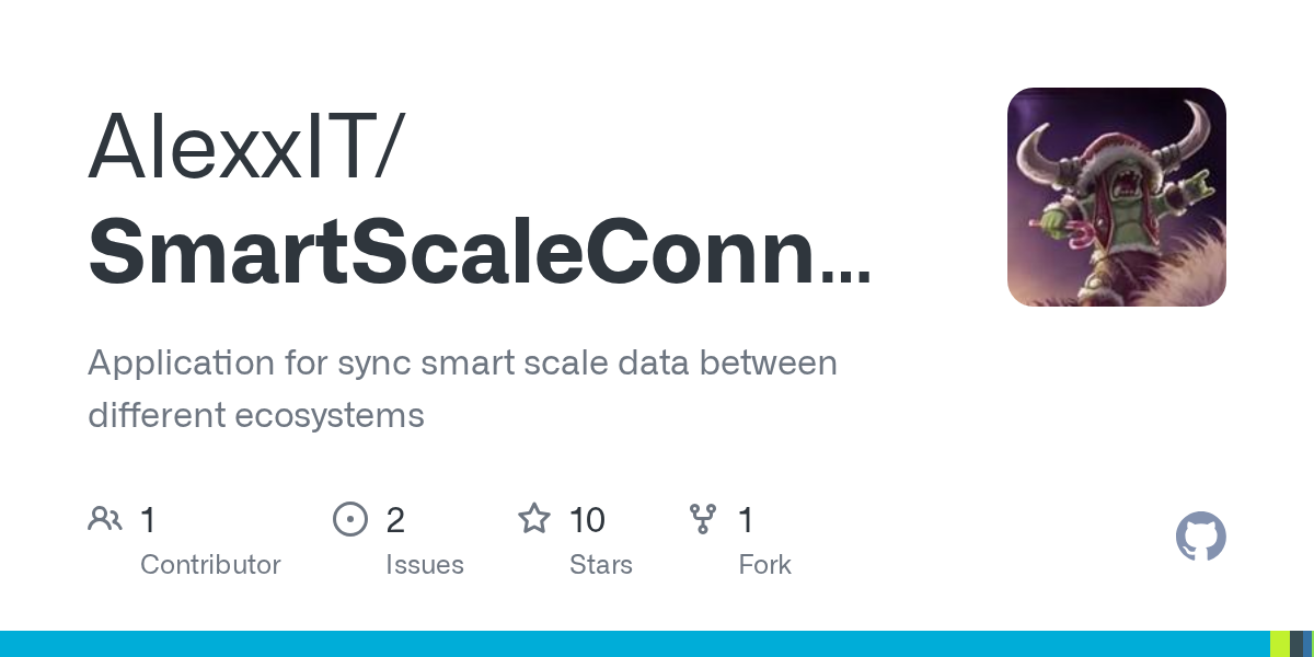

My new project for smart scale synchronization with support this model:
