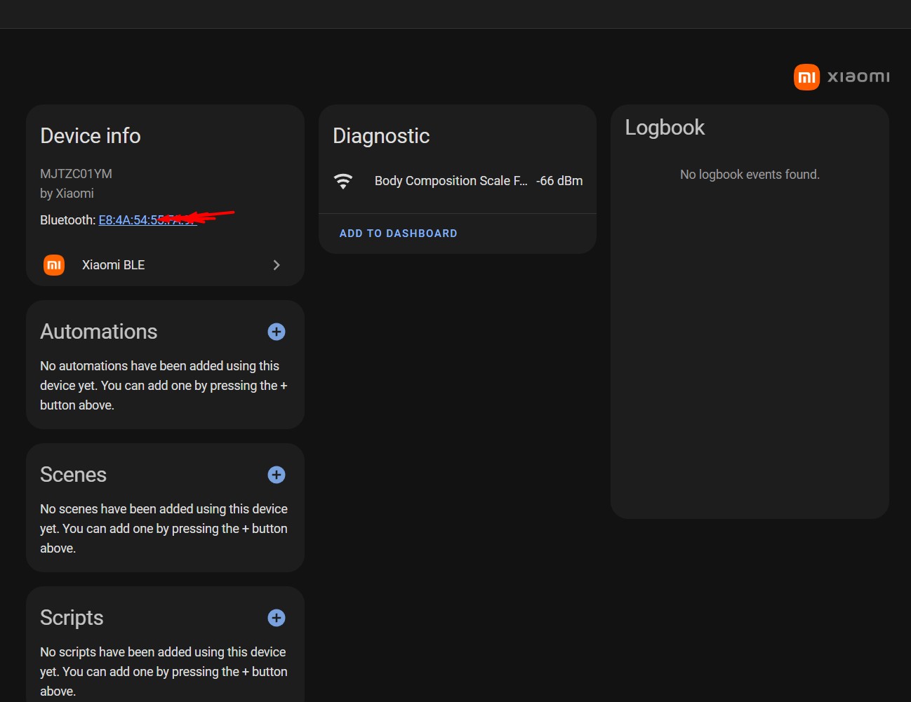

I got the scale and the latest update but it says that it has not been broadcasting for awhile bla bla bal. I stepped in on the scale, tried again still no luck. I got the Bodymiscale integration but it ask for the scale sensor entity which I dont have. The only entity I get is for the signal strength
Can you please give step by step how to get it working? thanks
Thanks for the work!
With HA Core 2025.5.0, the scale (a MJTZC01YM) started reporting its signal strength. Had to then add a bindkey which it took from my Xiaomi account nicely.
When I weighed, the low impedance and profile ID 1 were also reported. No weight or other values, though.
I was too fast, sorry! Well done! Seems time for another BT proxy here… :wink: It was a reception problem. When I moved the scale nearer to another BT proxy, all values showed up:

When trying to weigh for the first time, HA told me there was a Repair: Authorization for the Xiaomi BLE Scale was “expired”.
So I simply clicked the repair, which had two options, I took the recommended “get from your Xiaomi account”, entered my credentials, and it immediately integrated and started working.
(The scale must be registered in the Xiaomi Home app for this to work. After getting the key, the integration works completely locally.)
