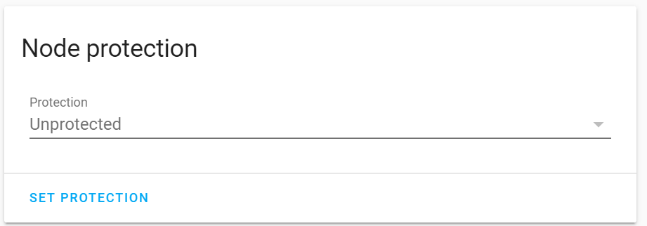

Now the only thing i would want to find out, how can i disable my fibaro shutter if the kitchen door is open? I have the check for automatic but if someone uses the switch manually it should be disabled. (easiest is to just cancel the command when the door is still open)
Thanks for sharing your configuration. I was thinking about your question. Assuming you are using Fibaro Roller Shutter 2, I found this in the manual:
Fibaro Roller Shutter uses the Protection Command Class v2 to prevent from unintended motor movement. Local Protection State:
0 - no protection. Roller Shutter responds to push buttons.
1 - not supported
2 - Local protection active. Roller Shutter does not respond to push buttons.
Once the Local Protection is activated, the module stops responding to S1 and S2 push buttons. SCENE ID and association commands will not be sent as well. The only exception is the B-button. Menu and Z-Wave network inclusion, after the B-button or S1 push button triple click, are still active.
In HA Z-Wave options for the Roller Shutter is the Protect option, I assume this is where you activate it:
Now to find out how you can use a service call to protect & unprotect… I don’t seem to find an appropriate one but perhaps you can find out?

Still seems to me like my suggestion could match what you are describing. If you could ‘protect’ the Fibaro from manual control (disabling the physical switch temporarily, turning it into a ‘dummy’), the Fibaro module would still be turned on. So in theory, it could detect the key press, and Home Assistant could respond by announcing ‘Hey close the door first’. Then when the door is closed, you could ‘unprotect’ the Fibaro and the buttons would work again.
Unfortunately this is all theory, but you could investigate further :slight_smile:
Edit: there’s even a configuration option for it… you should definitly try this :sunny:
Try to set it to different values and just check how the buttons are responding; is the button press still picked up by HA? If it works, you could set it from your automation using service zwave.set_config_parameter
I tried playing with it. But if you set it, it does still allow you to use a button. So it doesn’t work. Also if i click the options i see 3 options. No protection, Local Protection and 3rth one “Not Supported” perhaps that just indicates that it is not supported?
You can however protect the node. The setting below it.
But… when manually switching the device it doesn’t report back anything anymore.
