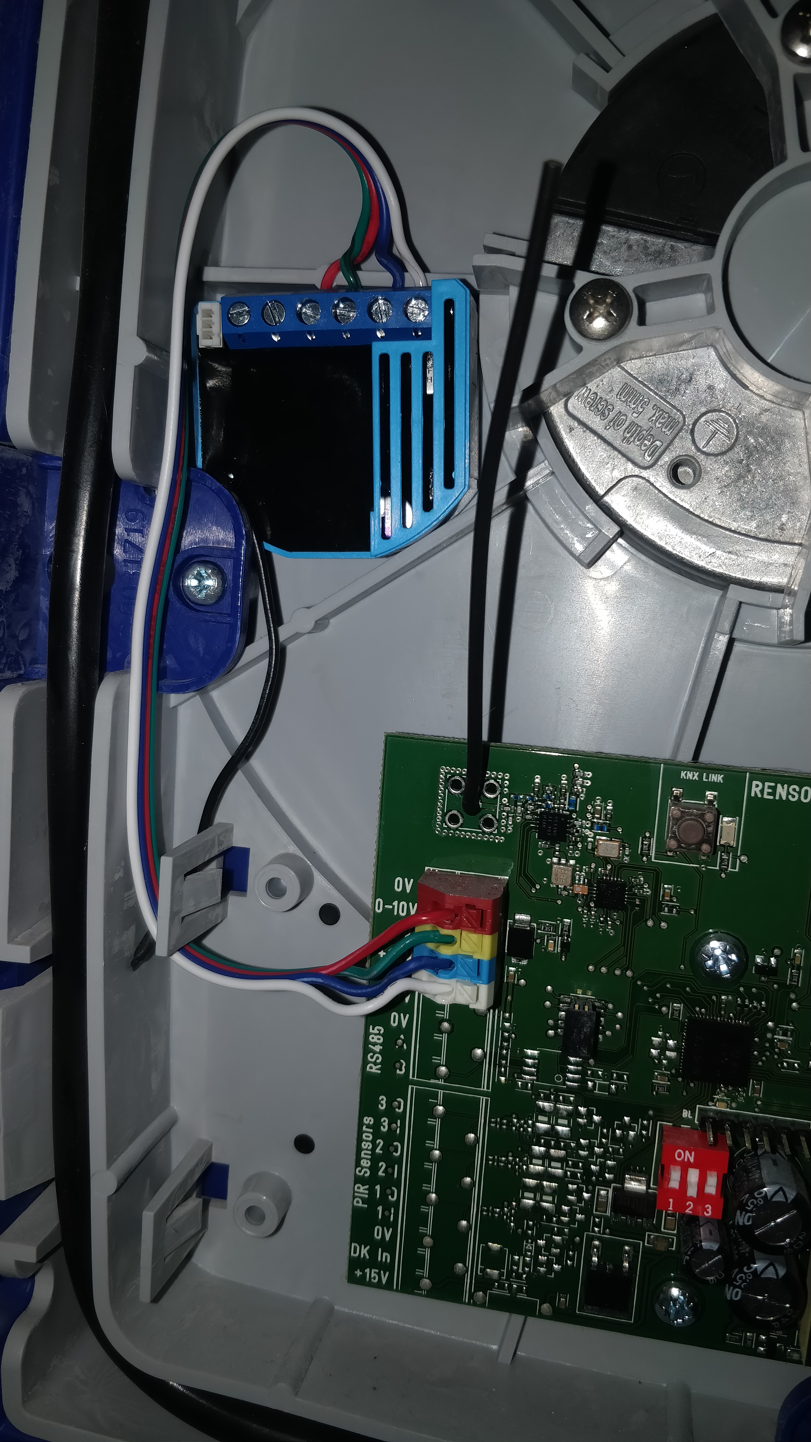

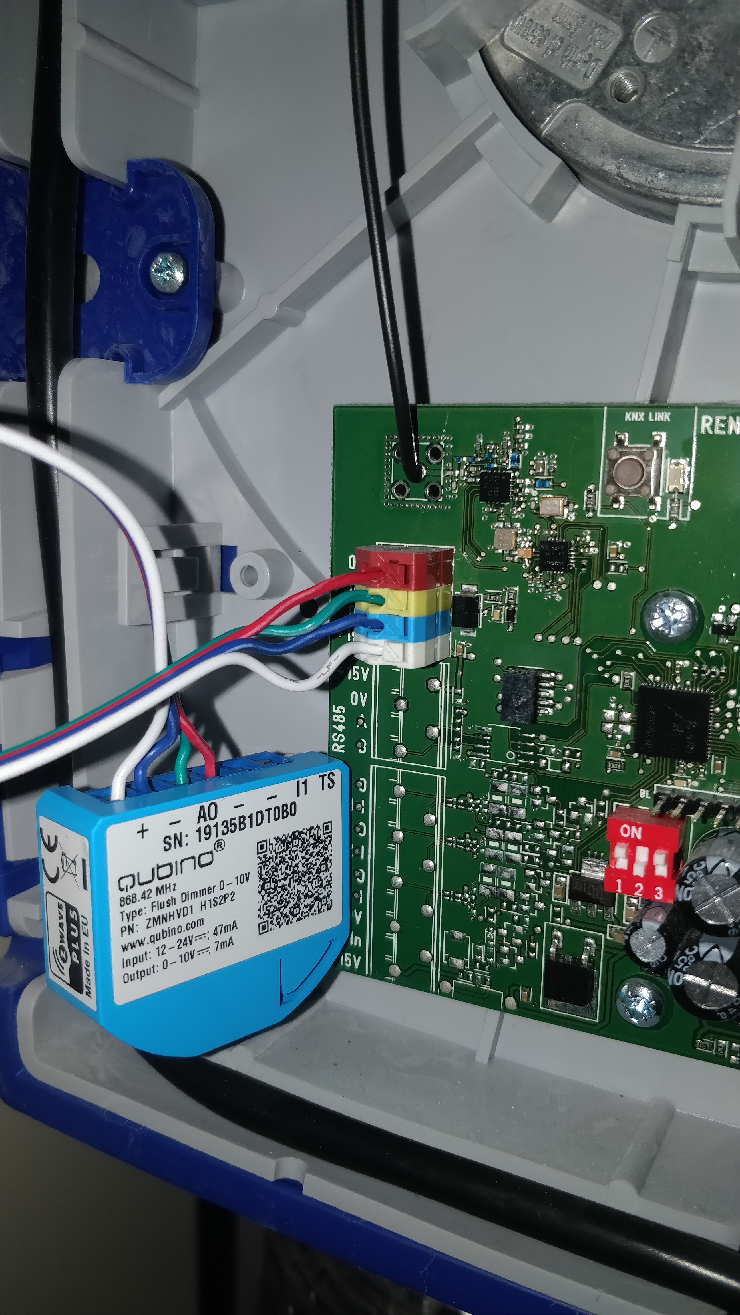

I’ve integrated the Qubino Flush Dimmer 0-10V (ZMNHVD1) with my central fan system (Buva Q-Stream) and it works perfectly!
The first dip switch needs to be set to ON in order to enable the 0-10V input (the yellow/red connections on the left hand side of the RENSON CubeH20 board).
See picture below for the connections / installation.
