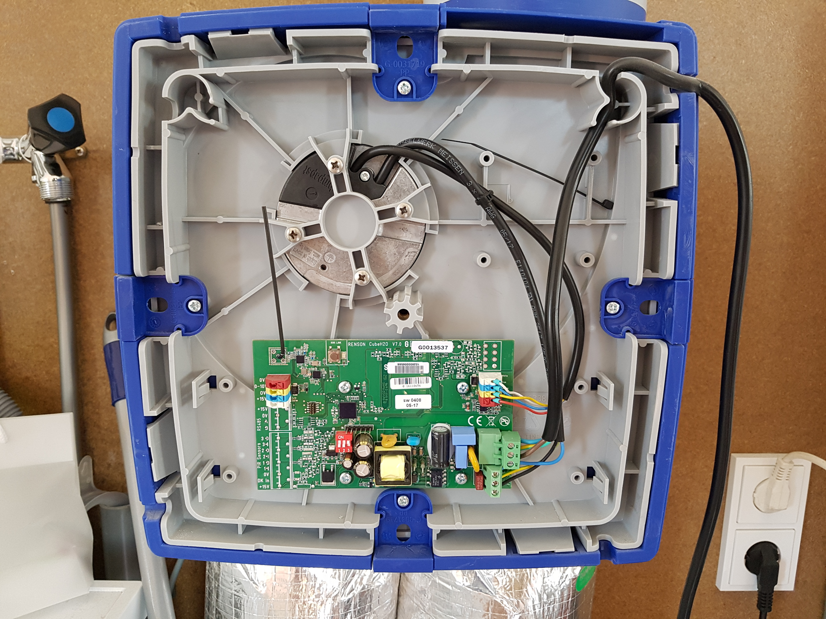

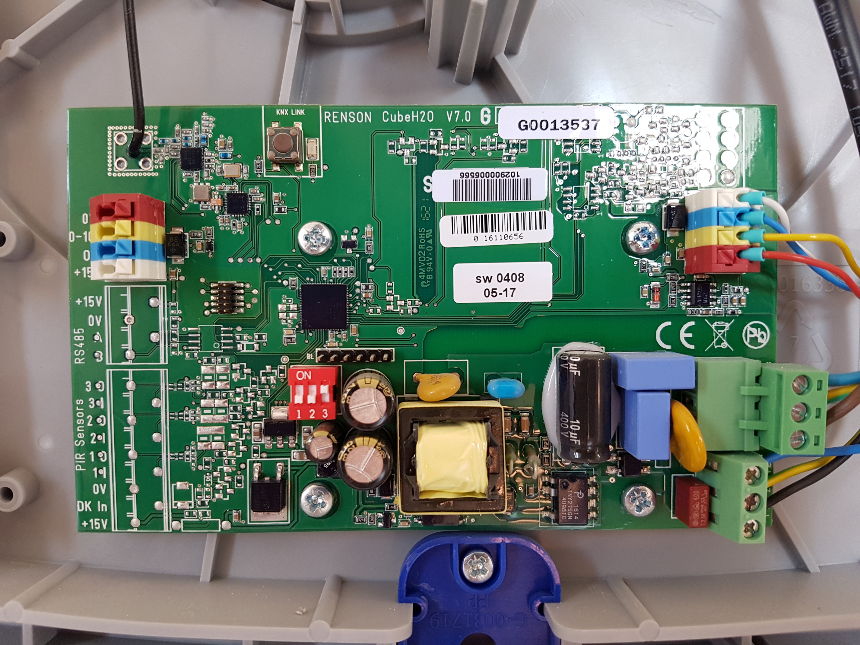

In my house is a mechanical ventilation (MV) that I want to automate with Home Assistant. So I searched on the internet for existing solutions and many are based on the famous ACM-LV10. See some example solutions I found in the bottom. Why I post a new thread is that the insides of this MV I have, differ on some points that are important. For some example: In my MV there are connectors based on 0v, 0-10v, 0v, +15v. This MV also has ‘switches’ (in the pictures red/white marked with “ON”), three in a row where others have more.
I also tried to lookup the type of board but no luck either ( RENSON CubeH20 V7.0 )
Can someone point me a direction to automate this unit? Do I have to worry about the volts? What to do with the switches?

I’ve exactly the same situation and have been reading several sites. This is what I think should be done:
  • Include a Qubino Flush Dimmer 0-10V to the Z-Wave network
  • Set the first dip switch to ON (this is to switch on the 15V output on the white/blue connections on the left side of the board.
  • Connect the white/blue connections to the input of the Qubino
  • Connect the red/yellow connections to the 0-10V output of the Qubino

I’ve integrated the Qubino Flush Dimmer 0-10V (ZMNHVD1) with my central fan system (Buva Q-Stream) and it works perfectly!
The first dip switch needs to be set to ON in order to enable the 0-10V input (the yellow/red connections on the left hand side of the RENSON CubeH20 board).
See picture below for the connections / installation.
