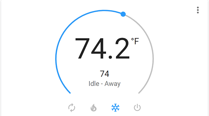

Hello, I’m trying to integrate the Thermostat temperature with the mini-graph-card card. Is it possible? I can not find my thermostat temperature sensor to perform the link.

I have an ecobee thermostat connected:

    sensors:
      temperature:
        friendly_name: "your current temp"
        unit_of_measurement: '°C'
        value_template: "{{ state_attr('climate.your', 'current_temperature') }}"
Will need to create the sensor from a template in configuration.yaml file. Replace “your” with the name of your thermostat.

Thanks for your help ! Worked as expected.
Brilliant thanks
Your post has helped me as well, thank you very much!
Small note: I had to change unit_of_measurement to °C (capital C instead of c) because otherwise it would break any helper sensor which I’ve added the temperature to. Took me a while to find out what’s wrong so you might want to edit it for anyone finding this in the future and copy-pasting your code like me :smiley:
