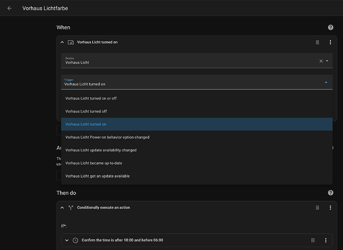

My goal is to have warm-white at night and cool-white in the morning.
I was trying to create an automation, but I can’t find a suitable trigger.
I tried to use the “Light Name turned on” trigger, but this only works when the light is turned on by homeassistant - not when powering on.
