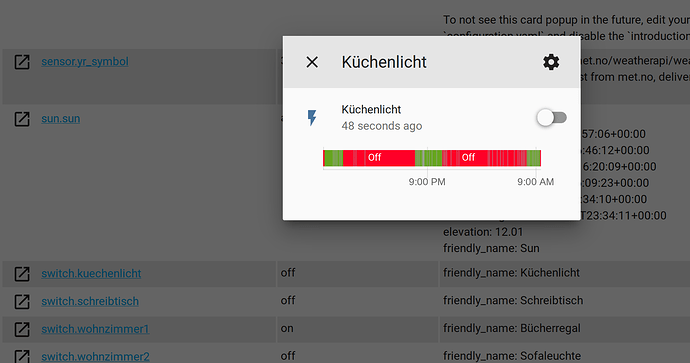

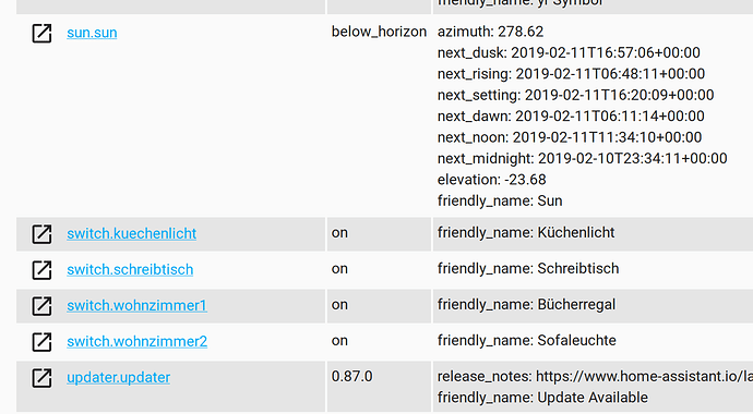

You mean the “states” view?
It gives me the info shown below, for one of the switches.
So what exactly do I have to enter into configuration.yaml to have this switch explicitly covered?
(Sorry if this a stupid question, but I’d be surprised if hass can set up this switch with the info “friendly_name” alone).
Yeah I was wondering if there was a way to derive the missing Etc, etc stuff from existing files, since that information must already be there from the auto-discovery. Seems that there isn’t and that stuff must be obtained using trial and error. But thanks anyway!
