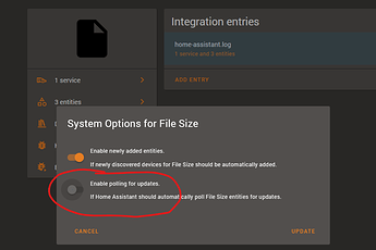

Since 2023.06 the platform filesize moved to devices which works thanks to the auto migration.
One thing is unclear to me.
With platform: filesize I set the scan interval to 1800 to not write to the database that often. In the UI I can not find any option and the manual does not mention anything?
How to change the scan_interval of filesize since 2023.06?
