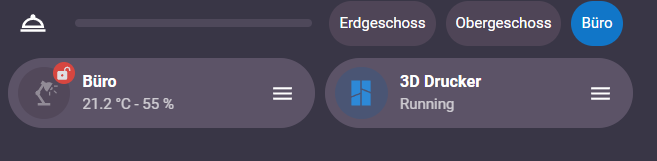

I tried to achive something similiar, it’s about changing the layout of my dashboard. Which i did with input_boolean’s triggering the correct layout, but for sure also having the user context in mind.
These 3 Buttons are just visible for my user, the ones for my wife are called the same, but in the background the will trigger a different boolean.
An automation in the background is always toogling off the boolean if another one is triggered.
Here is a visibility rule for some cards below:
