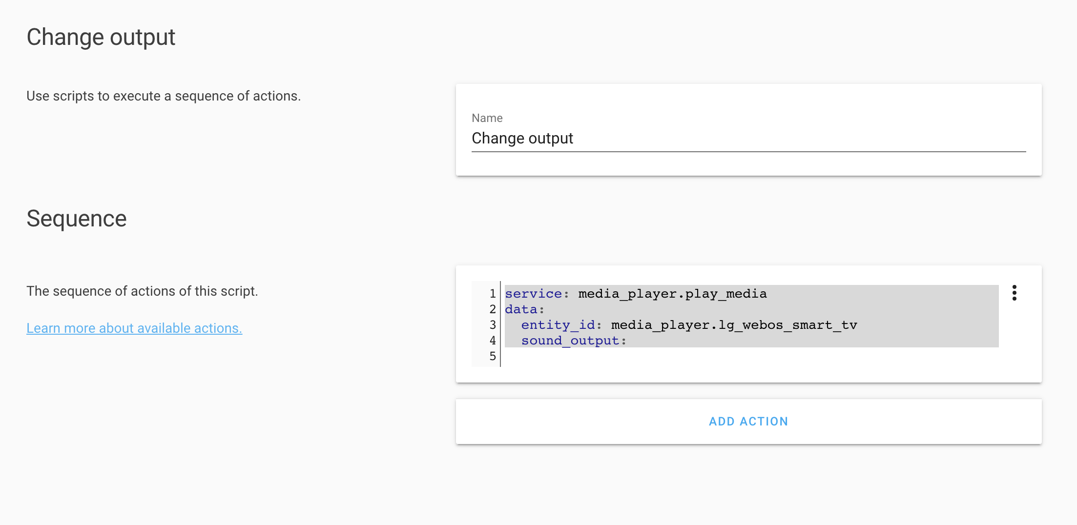

Just started with Hass, so might make some rookie mistakes: but created this script
But how do I know which options can be used at sound output?
Hi rttryv,
You need to use the service webostv.select_sound_output
in place of media_player.play_media
Regards
Ah, actually meant which outputs can be used for the variable sound_output
Every sound_output capabilities of your tv can be used.
The more easy way to know the name of the sound_output tu use is to change manually (with your tv remote control) the sound ouput in the TV, and for each one go into home assistant, in developement tools, then in states, and check the states of your media_player.yourtvname
There you will find the real name of the current sound_output selected, for exemple (tv_speaker, tv_headphone, …)
Regards,
Great! Found it and it works! thanks
