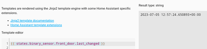

It isn’t clear to me why last_changed is coming back UTC for me, but I solved it by using utcnow() instead of now().
I also noticed that for my double doors, I had to use the individual sensors front_door_left and front_door_right instead of the front_door sensor group. In other words, the logic didn’t work if I tried to place a group sensor (front door) within a group sensor (outside doors), which I had initially done to save time.
It’s always UTC. That’s the default for all of Home Assistant’s datetime values.
When performing datetime arithmetic, as long as all values have a timezone, the calculation is performed correctly even if their timezone offsets aren’t identical.
The following example demonstrates that the difference between two datetime values is the same, regardless of which one is utc or local timezone.
