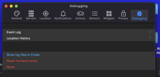

Right click on HA icon in the menu bar and open Preferences. Then go to Debugging tab and you will find there option to Reset frontend cache:
Screenshot 2024-09-29 at 11.51.54
Thank you so much! I run the app in fullscreen on a second portable monitor. Never occured to me to check the menubar for preferences :confused:
i know i’m posting to a stale thread, but i’ll just point out that in the mac companion app version 2025.5 (2025.1264) there is no feedback or confirmation when clicking on “reset frontend cache”.
there’s kind of a delete-button icon that appears to the left of the text. i can click on the icon, i can click on the text and nothing happens (visually) - button doesn’t highlight or blink or anything. it really doesn’t behave like a button. it may be working perfectly behind the scenes. it may be doing nothing. it may be a bug. i can’t really tell.
in contrast, if i click either the “reset app entities database” or “reset app” button (just above/below the reset frontend cache button respectively), then i get an immediate “are you sure?” dialog.
