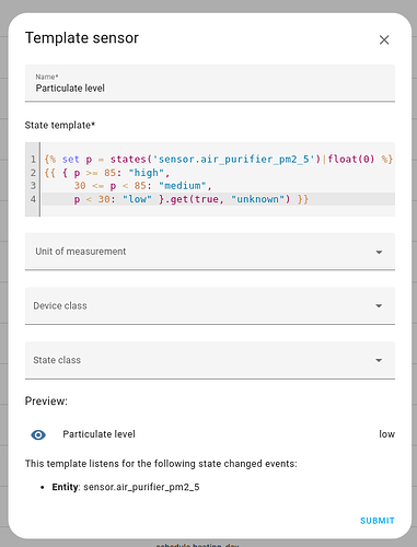

Can I add a helper with a sensor template and switch modes according to the measured values within the set ranges? Can this be done?
Yes. So a template sensor with a state template like this:
{% set p = states('sensor.air_purifier_pm2_5')|float(0) %}
{{ { p >= 85: "high",
     30 <= p < 85: "medium",
     p < 30: "low" }.get(true, "unknown") }}
(which is just a shorter way to write a load of if statements: it’s a dictionary where only one key will be true at a time).
That will check and adjust its state every time the PM2.5 sensor publishes a new state.

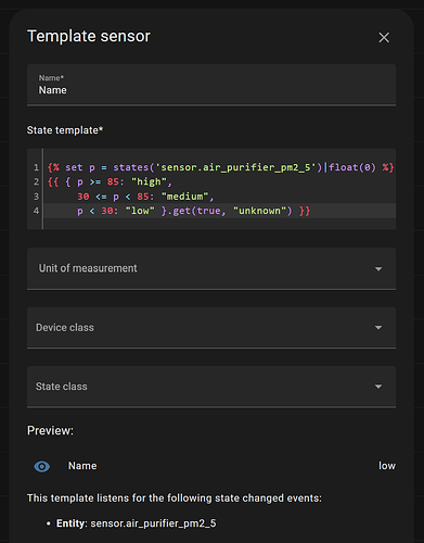

I’ve made a helper but I’m stuck. The helper does not have an entity ID and in Preview there is this message: Sensor None has device class 'pm25', state class 'measurement' unit 'µg/m³' and suggested precision 'None' thus indicating it has a numeric value; however, it has the non-numeric value: 'medium' (<class 'str'>). What do I do now?
Did you chose Template{}
You leave a lot of the boxes blank. Should look like this:
and that will give you sensor.particulate_level.
(edit: ninja’d by @LiQuid_cOOled and they even have dark mode on!)
I see now. Thanks. I did it this way which was obviously incorrect:
Always Dark Mode :sunglasses:
Dark mode rules and it’s cooler than cool :cool:
