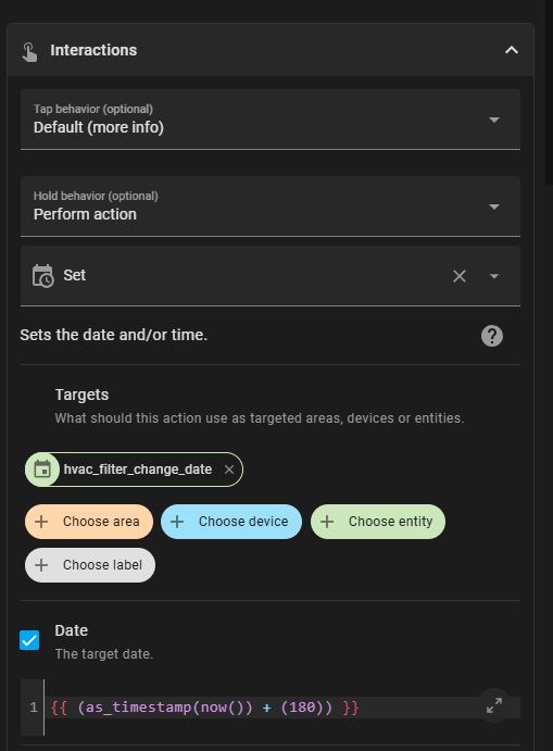

Now my issue is trying to figure out why I can’t get the hold interaction on the gauge I made to run an action to set the helper’s date as a function of 180 days from now (see pic). Any thoughts?
Most core cards do not support templates. Call a script as the action and use the template to set the date in the script.
…could I bother you for a how-to on that? I’ve been trying for the last hour and I guess there must just be too many gaps in my knowledge.

Try:
  - action: input_datetime.set_datetime
      entity_id: input_datetime.hvac_filter_change_date
      date: "{{ ( now() + timedelta(days=180) ).strftime('%Y-%m-%d') }}"
Actually try that in the card action first just to make sure. I’m almost certain the action does not support templates, but it might. If not then put it in a script.
That worked in the script but not in the card. Thank you so much for your help!
Thanks for confirming that the template is not supported in the card actions.
