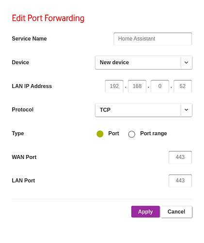

Port forwarding on router:
From what I understood, this should suffice to make my instance accessible. However, accessing https://<subdomain>.duckdns.org only yields (after a long time of loading) “This site can’t be reached: <subdomain>.duckdns.org took too long to respond.”
Open Port Check Tool - Test Port Forwarding on Your Router shows that port 443 is open. Can anyone explain to me what I’m doing wrong?

I also see you added 172.30.32.0/24 and 172.30.33.0/24 to your trusted proxy, but in your router config, you shows home assistant with an address in the 192.168.0.0/16 range. Which range is your network using?
172.30.33.0/24 should be added according to the NGINX docs (addons/nginx_proxy/DOCS.md at 09b61a1423e46d5be75804f8c26a7fb1d67601a8 · home-assistant/addons · GitHub), while 172.30.32.0 was mentioned in the error logs I posted above, so I thought it may help to add that as well. I also tried adding 192.168.0.0, but to no avail.
What do you mean by that? The internal IP is visible in the screenshots. Should I add anything else to the trusted proxies?
