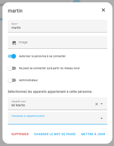

  • added him as a Person:
I then created an automation and chose “Areas” as the trigger. Unfortunately, the only entries that are available are my wife and myself, but not him:
What am I missing?
