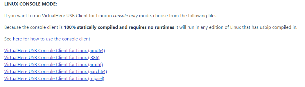

Would it be possible to start virtualhere in console mode on HAOS? Would that be a working solution? It only needs usbip drivers and i read somewhere that these are compiled into HAOS. Btw, not a clue how to proceed since i’m a real linux newbee despite 25+ IT career :slight_smile: so any help would be appreciated.
https://www.virtualhere.com/usb_client_software
