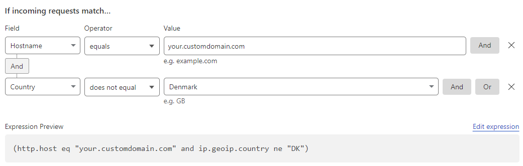

I was going through this tutorial scratching my head wondering why it’s still not working, then realised I set up WAF to block all traffic from other countries :sweat_smile:
Is there a clean rule to allow only Google’s IP’s? I see quite a range of them in the firewall events.
Edit: Found the trick, allow AS Num 15169 throguh

In Cloudflare create a new Custom WAF rule, (Security → WAF) paste this code (is from this Reddit post) :
(ip.src in {8.8.4.0/24 8.8.8.0/24 8.34.208.0/20 8.35.192.0/20 23.236.48.0/20 23.251.128.0/19 34.64.0.0/10 34.128.0.0/10 35.184.0.0/13 35.192.0.0/14 35.196.0.0/15 35.198.0.0/16 35.199.0.0/17 35.199.128.0/18 35.200.0.0/13 35.208.0.0/12 35.224.0.0/12 35.240.0.0/13 64.15.112.0/20 64.233.160.0/19 66.102.0.0/20 66.249.64.0/19 70.32.128.0/19 72.14.192.0/18 74.114.24.0/21 74.125.0.0/16 104.154.0.0/15 104.196.0.0/14 104.237.160.0/19 107.167.160.0/19 107.178.192.0/18 108.59.80.0/20 108.170.192.0/18 108.177.0.0/17 130.211.0.0/16 136.112.0.0/12 142.250.0.0/15 146.148.0.0/17 162.216.148.0/22 162.222.176.0/21 172.110.32.0/21 172.217.0.0/16 172.253.0.0/16 173.194.0.0/16 173.255.112.0/20 192.158.28.0/22 192.178.0.0/15 193.186.4.0/24 199.36.154.0/23 199.36.156.0/24 199.192.112.0/22 199.223.232.0/21 207.223.160.0/20 208.65.152.0/22 208.68.108.0/22 208.81.188.0/22 208.117.224.0/19 209.85.128.0/17 216.58.192.0/19 216.73.80.0/20 216.239.32.0/19} and ip.geoip.asnum eq 15169 and http.host eq "ha.example.com:1234" and http.request.uri.path eq "/api/google_assistant") or (http.request.uri.path eq "/auth/token")
Remember to replace the ha.example.com:1234 with your host and port #.
In “Choose action” select “Skip” and choose all the WAF components to skip (expand also the “More components to skip”).

This worked in my case aswell. It’s important to notice, that the block countries rule comes in second and the google asn skip is in first place! I got them flipped first.
