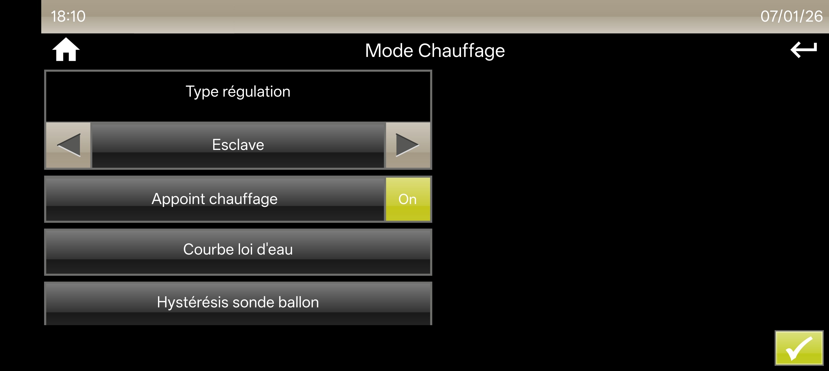

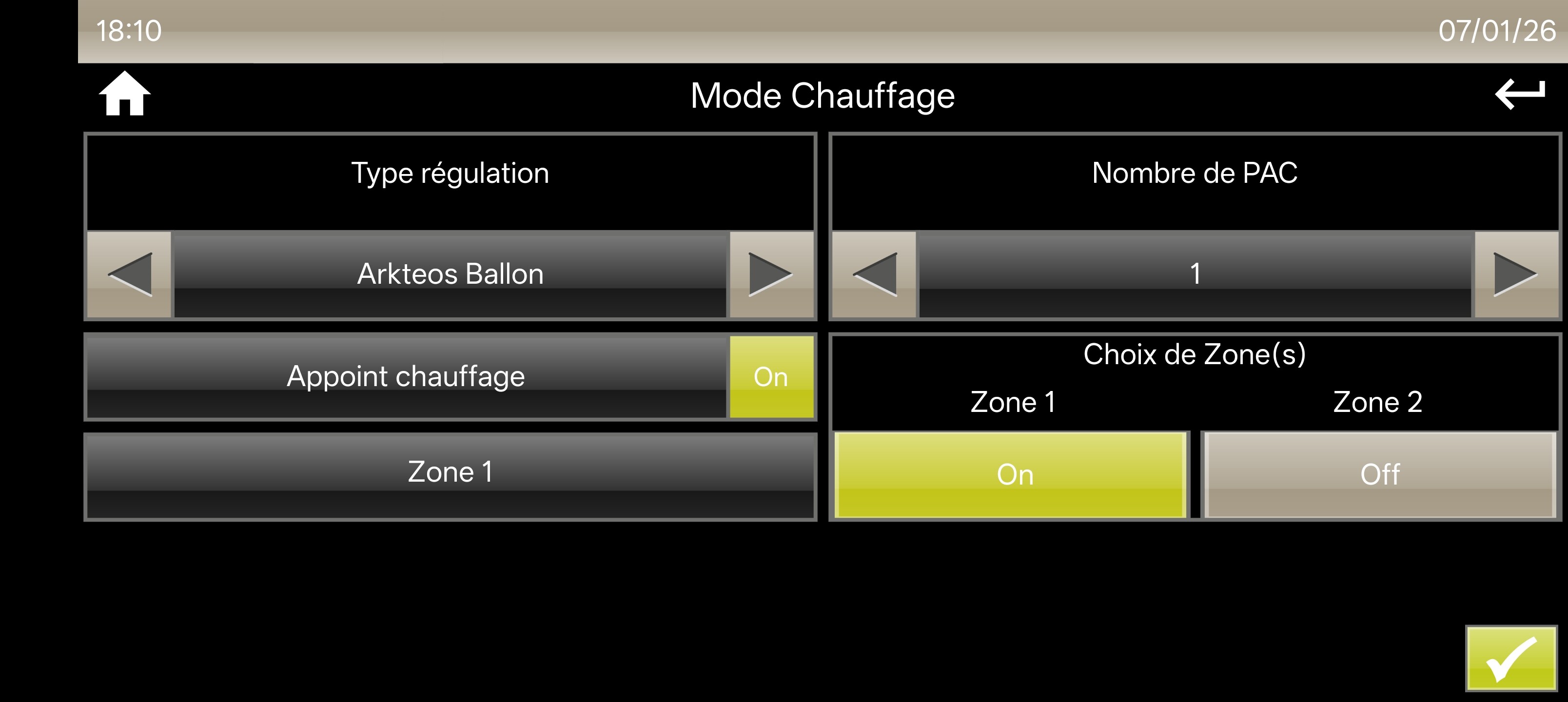

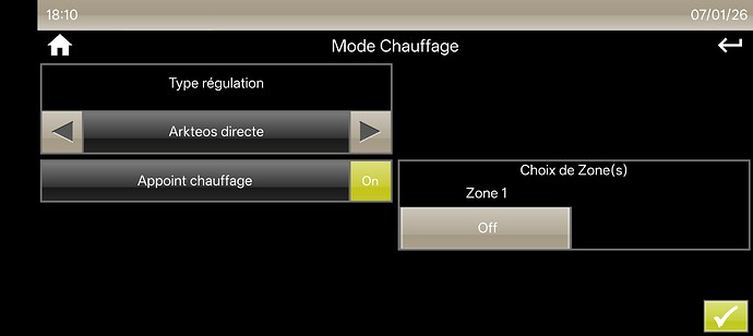

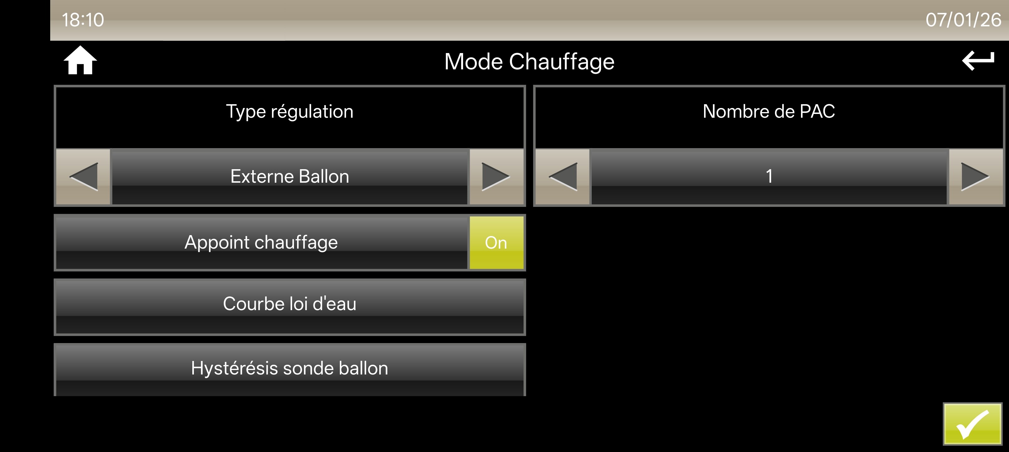

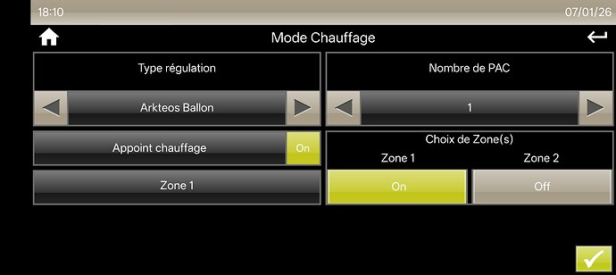

Hi, I also have a arkteos. I use versatile to control my heater head, and some scheduler.
But don’t know in which mode need to set my Arkteos.
